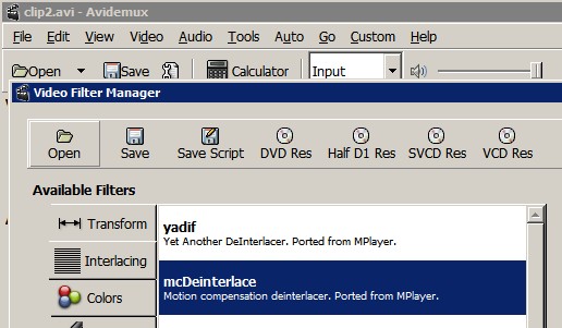

You can do some fast comparisons of deinterlacers via Avidemux2
