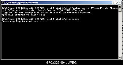

  19. Click image for larger version
    File directory: D:\ffmpeg-20140806-git-305f72a-win64-static\bin
    Movie is YIFY MP4 file.
    Wild guess: you somehow created a UTF-8 file which adds the first three bytes to the command-line, and the result is garbage.
    BTW --- "YIFY" is a subject that not only violates the forum rules, but also suxxx terribly
  21. Originally Posted by El Heggunte View Post
    I changed from UTF-8 to ANSI and its working. Thanks.
