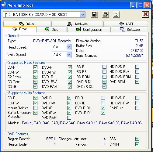

    I’m having trouble backing up a DVD9 to a DVD9. I have a Toshiba 5372 drive with firmware TU56. I’ve used DVDdecrypter to build an image and burn an image. That failed with a write error. I used DVDshink ins DVD9 mode to build and image. That failed during writing with dvddecypter. I tried using DVDfab to extract all the files and then used DVD shrink to build the ISO. Then used DVDdecypter to burn image. That failed during burn too. I have no problem burning DVD5 discs. Is there some sort of setting I need to make? Am I missing something? I wasted a few dvd9 discs during this testing. I’m gonna get a rewritable till I get this right.

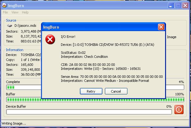

  6. Well, Tried BurnImg and got the following

    The discs are not very good quality to start with, so that may be the cause of your problems. Imgburn is also saying they are incompatible - are you sure your burner can write to these discs ? You don't say if you are using - or + R DLs.
    But as pointed out, if you don't use Verbatim +R DLs from Singapore, you might as well flush your money down the toilet.

    The drive is both Plus and minus. I'm using Plus disc.
    You may need a firmware update to burn that particular disc.
    You also seem to be studiously avoiding the issue that these are crap discs, and may never burn well for you. Accept that you have done your money, and go and buy some Singapore manufactured Verbatims.
