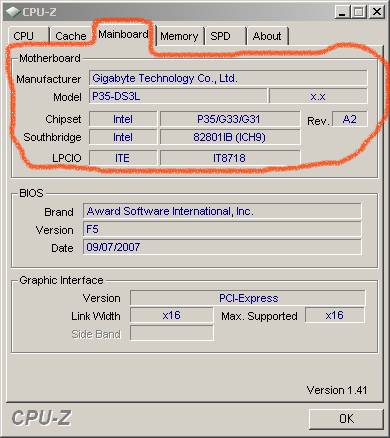

That doesn't give the motherboard model number so download CPU-Z. It will show you what model motherboard you have. Here's what it would look like:Originally Posted by jbartosh
http://www.cpuid.com/cpuz.php
Create a new folder on your desktop & name it CPUZ and then download CPU-Z. Then unzip it to that folder you created. All you do is double click on the CPUZ icon and then it will show what motherboard, processor and memory your computer is running.
Okay here is the information......
Manufacturer ASUSTeK Computer INC.
Model 'P4SD-LA'
Version Rev 1.xx -
