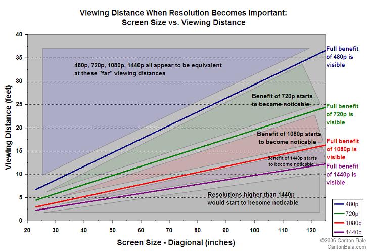

As to what specific model to buy, it really depends on several factors - starting with room size and typical viewing distance. A larger room requires a larger screen size. The ability to visibly benefit from a high resolution HDTV depends alot on how big the screen is and how far you sit from it. Keep in mind that only 1920x1080p native resolution displays can actually produce all the potential image detail available with 1080i and 1080p sources.
Have a look at this article about screen size, viewing distance and native resolution:
http://www.carltonbale.com/2006/11/1080p-does-matter/
