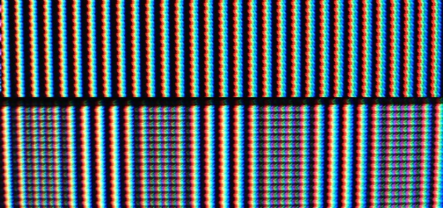

My HDTV is a 1080p model which has the option of 1:1 pixel mapping or regular 16:9 overscan. Here are some example close up photos of the screen displaying single pixel wide black and white stripes, photographed with a digital camera, in 1:1 mode (top) and with overscan (bottom):
The pictures aren't real clear (I was just holding the camera up close to the TV) but you can see every line in the 1:1 image. There is obvious artifacting in the overscanned image.
