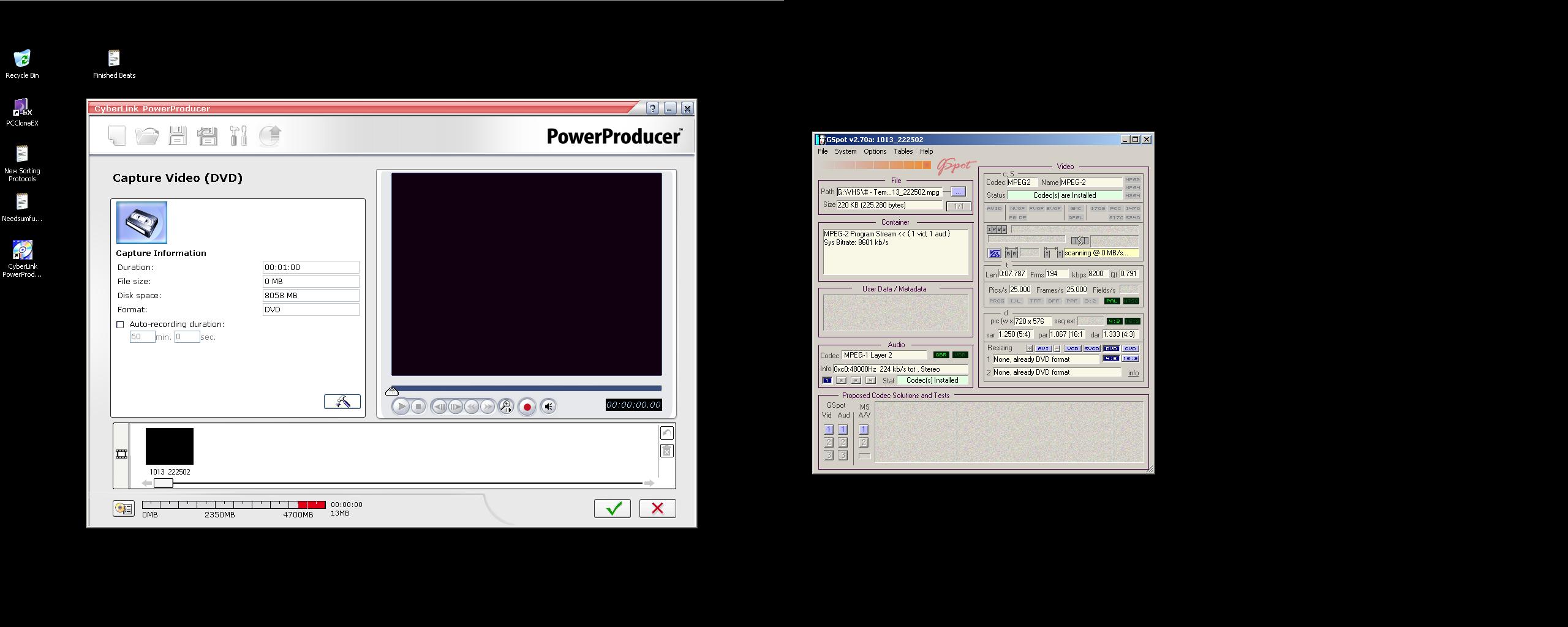

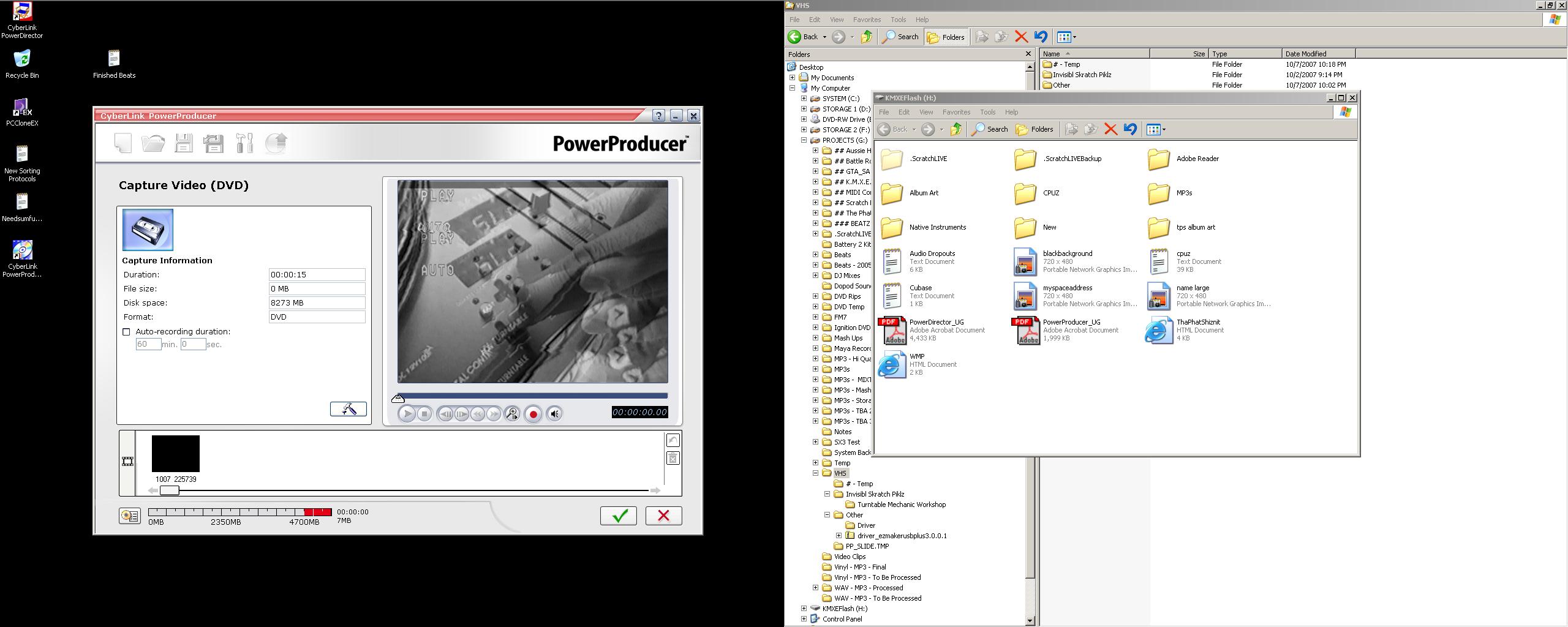

One weird thing that I have noticed is that when i disconnect the yellow video cable and then reconnect (while the video is playing) , a blurred/distorted/partial b/w image appears of whatever is on the video tape and then is frozen on the screen (refer to the image file).
Is this a faulty unit? Is there some other setting I can check? Is there something that is so obvious yet I've missed? Any help would be appreciated - thanks in advance.

Do you get a file? If so, try recording a minute -- even if you don't see any picture. Then open the file with GSpot. What does it say about the video (post a screenshot)? Try opening the file with VirtualDubMod. Scroll through the video. Do you see a picture?Originally Posted by kmxe
Check out the screenshot of GSpot. With VirtualdubMOD - it keeps crashing whenever I try to open the video file, and to be honest - I'm not sure why it is or what to do. When it crashes it keeps saying there is a access error with the app.Originally Posted by jagabo
