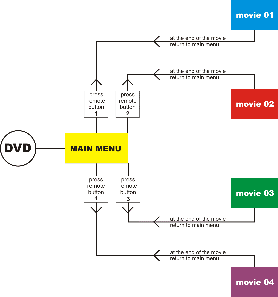

    So, after trying to achieve it in encore has failed, here is a scheme of what is desired.
    Please do help me if you can, as this project is very important for a volunteer work I am doing for a museum.
    Thanx again
