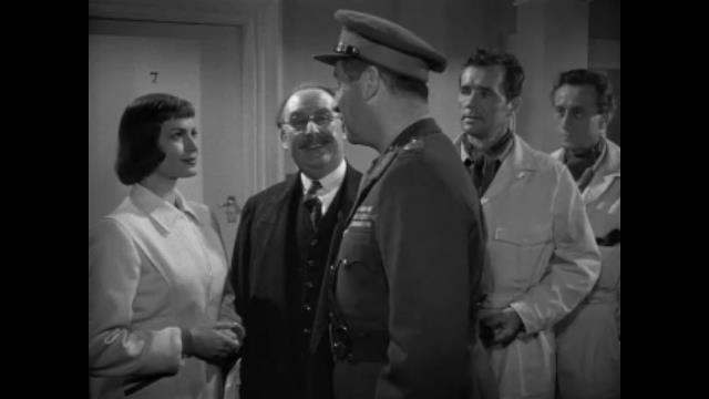

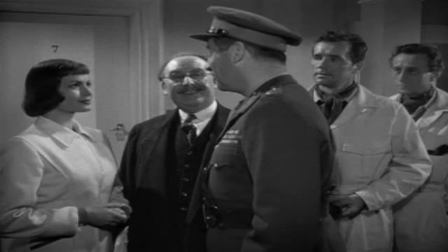

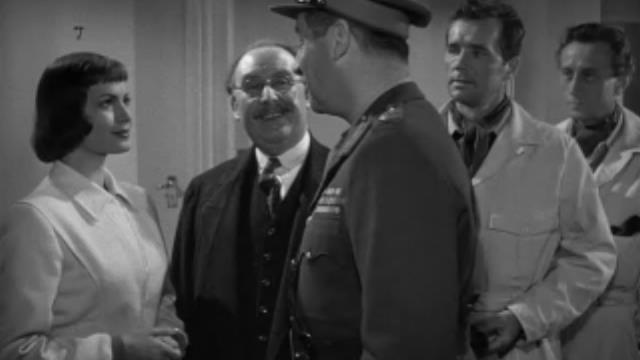

  17. Here's a 4:3 source:
    Pillarboxed to 16:9:
    stretched to 16:9:
    zoomed and cropped to 16:9:
    Are you seeing one of those? That's pretty much all the options you have.

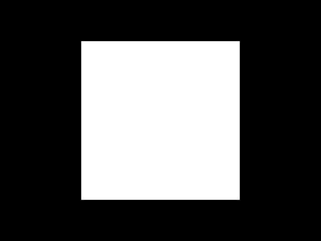

  29. Originally Posted by SE14man
    So set the TV to 4:3? If i do that i get 2 really big thick black lines on the left and right of the screen.
    That is the way 4:3 material is supposed to be viewed on a 16:9 display. The part of the screen with the 4:3 picture will have the correct aspect ratio. If you set your TV to display as 16:9 you will be stretching the picture and everything will look "fat".
    This picture should show a white square, not a rectangle.
    You may need a new graphics card if you want 16:9 output. Does your HDTV have a VGA input? That would deliver much better picture quality and may allow you to get 16:9 resolutions.
