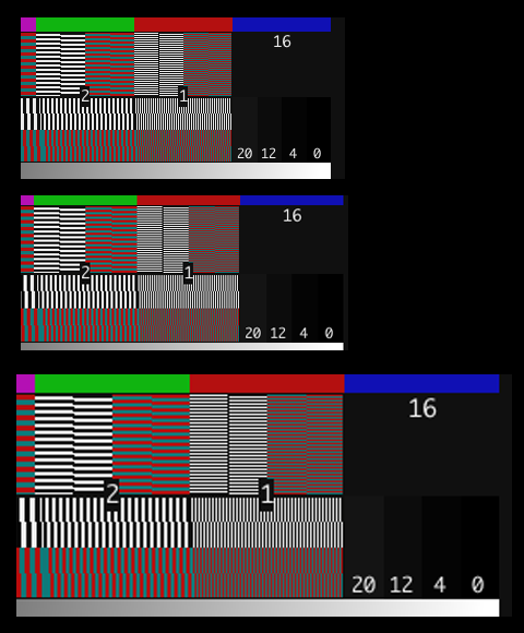

Also keep in mind that there are few 720p displays with native 1280x720 resolution. Any incoming 720p signal will be resized to the native resolution of the TV. Even with a native 1280x720 resolution most displays will overscan the frame -- they will enlarge the frame by about 5 percent and then cut off 5 percent of the image around the edges.Originally Posted by gshelley61
So both 720p and 1080p displays will resize an incoming 720p signal. The 720p display is not likely to look better than the 1080p display.
In fact, it can be argued that enlarging by ~55 percent (720p to 1080p plus overscan) will give better results than enlarging by 5 percent (720p plus overscan) assuming that they are both displayed at the same physical size. Enlarging by small percentages leads to severe moire artifacts. Here's are some crops from an original image, one enlarged by 5 percent and another enlarged by 55 percent:
Notice how the 5 percent enlargement has much more severe moire artifacting? This is because the larger display has more "in between" pixels to work with. (Keep in mind that both of them would be displayed at the same physical size on the TV screens, the 720p display would simply have larger pixels than the 1080p display.) Of course, real video wouldn't have lines this sharp but there are times when moire artifacting can be quite visible.
As far as upscaling SD resolutions to 720p or 1080p displays, the quality of the deinterlace and upscale filters will be more important than the difference in native resolution. -
