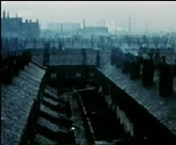

Here is a screenshot. I want the actual picture to fill the screen. (including the black borders). I have worked out how to change the screen size to various others, but I cannot find out how to change the actual pictures to fit the screen.
It looks like someone resized a half D1 frame to VCD without doubling the frame width (relative to the height). I'm assuming the dimensions of the frame are 352x240 since you say it's VCD:
Crop 80 pixels off the left and right sides. Resize what's left to 352x288. Encode back to PAL VCD compliant MPEG. -
