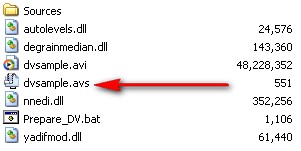

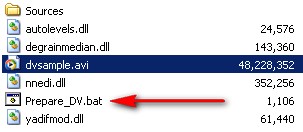

You can try this little experimental script which attempts to clean up the DV source a bit before encoding to Mpeg2.
Needs Avisynth, and if you don't already have a VFW DV codec installed, download
http://www.free-codecs.com/download/Cedocida_DV_Codec.htm
Instructions:
1) Download
prepare_dv.zip
2) Unzip, place DV AVI in same folder, and click .BAT file
3) Feed AVS file to your Mpeg2 Encoder
* Note: I think this will only work with NTSC material, but I could be wrong.
* Note2: This isn't going to be fast, and the limitations of DV make it difficult to "polish a turd". Still, I think it looks pretty good, I'm just not sure
