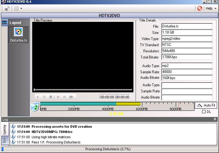

    using the HDTV2DVD but don't feel much positive this will work, notice the resolution still shows the same....
    When I play the resulting MPG file from MPEG StreamClip using WMP let me tell you that the resolution is pretty good, it's gotta be 720x480 or higher, so not sure why these programs show a lower resolution.....something is wrong somewhere...!!!
    See screen (I cannot make changes to the res. numbers)

    Resizing is one of the things HDTV2DVD should do. The output from ffmpeg looks a little more promising - 4778 kbps video - which is fine for that res. Wonder where the 1706 kbps is coming from?
    /Mats

    Thanks guys for all the support, last night I let hdtv2dvd do its thing and it gave me the VIDEO_TS folder, I finally burned my DVD using ImgBrn.
    The DVD picture is good, obviously NOT highdef but it looks almost the same as the original movie, looks like I lost a little pic quality, however it is not much.
