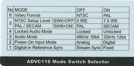

Make sure setup switch is in the 7.5 IRE position. Otherwise the ADVC is correct in levels.
PAL uses zero IRE. -
dip switches on ADVC-110
Switch 6 - Off
Switch 5 - On
