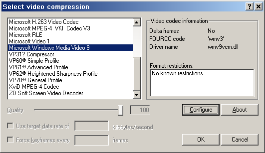

    http://en.wikipedia.org/wiki/Wmv#Container_format says:
    Although WMV is generally packed into the ASF container format, it can also be put into the AVI or Matroska container format. The resulting files will be have the .AVI, or .MKV file extensions, respectively. WMV can be stored in an AVI file when using the WMV 9 Video Compression Manager (VCM) codec implementation. Another common way to store WMV in an AVI file is to use the VirtualDub encoder.
    VirtualDub says:
  7. Well, there you go!
    I will amend my original reply.
    Though if you want WMV format in a way that is most widely used, it makes sense to use the free-standing format (IMHO).
    John.
