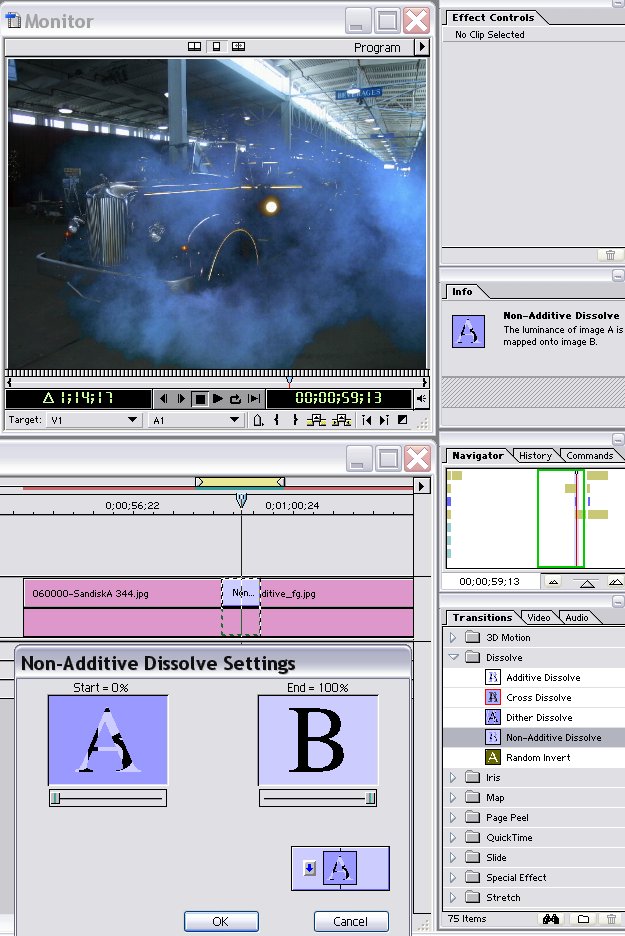

	Try Non-Additive Mix (NAM), a classic switcher composite effect used for smoke or lightening.
 Since it is a YCbCr mix based on luminance level, edges may be less harsh than a luminance key. Pixels above the mix threshold are passed to foreground from A or B. Whichever pixel is higher in luma value, that YCbCr pixel is passed 100%.

	Look under Transitions - DissolveOriginally Posted by wturner
 http://ppro.wikia.com/wiki/Transition:_Non-Additive_Dissolve
 Here it is in Premiere 6.5. Pro is similar.
	The other image. Strongest pixel comes through 100%. See light.
