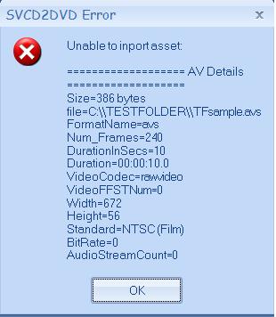

    Sep 2007
    heres the script
    # -= AviSynth v2.5.7.0 sample1 script =-
    AVISource("C:\TESTFOLDER\Sample1.avi")
    Blockbuster(method="noise",detail_min=1,detail_max=3,variance=0.1,seed=1)
    Deen("c2d",2,4,6,4,6,0.5,9,"")
    asharp(1,4)
    UnDot()
    BicubicResize(688,272,0,0.6,6,0,628,272)
    Blockbuster(method="noise",detail_min=1,detail_max=10,variance=0.3,seed=2)
    AddBorders(16,104,16,104)
    #Trim(0,206369).FadeOut(150)
    and the error
    i,ve used the same script on other samples but they had mp3 audio
    and they worked ok

    Sep 2007
    loading the TFsample script into
    MPC (unicode build) Version 6.4.9.0
    or
    WMP Version 10.00.00.4058
    or
    VirtualDubMod Version 1.5.10.0
    i get No compatible ACM codec to decode 0x2000 audio stream
    to PCM (C:TESTFOLDER\TFsample.avs,line 2)
    but if i just load the avi into them app's it plays fine
    BTW it as ac3 audio
    it only does it with files containing ac3 audio
    Loading Sample1.avi in Gspot it says for the audio
    Codec
    Name ac3 (0x2000) Dolby Laboratories, Inc
    Birate 448 kb/s (6 ch) CBR Fs 48000 Hz
