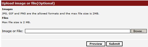

  23. Member mr nice's Avatar
    Oct 2007
    Dwight can you tell me how to attach a zip file so chrissy can see the results of the conversion and the log.
  24. Click "post reply" and it should be here:
    browse to the file on your computer and hit "submit" - should work.

  25. Be sure the file is under 2MB.
