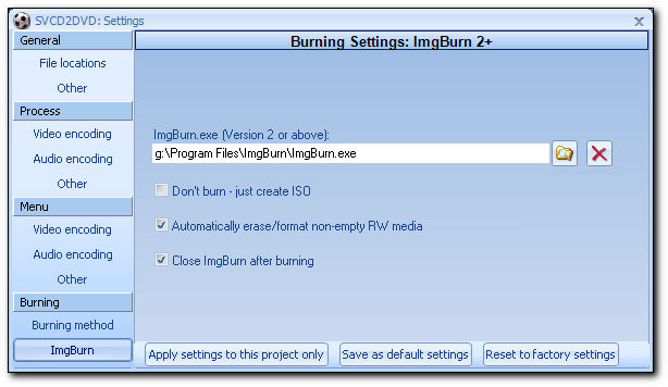

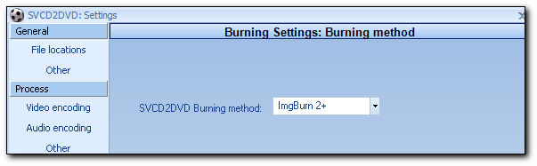

Can you tell me how to link the burning software to your program? How do I get to logs? are the logs you've asked for, are they the same logs I have showed you already or am I showing you the wrong log?
