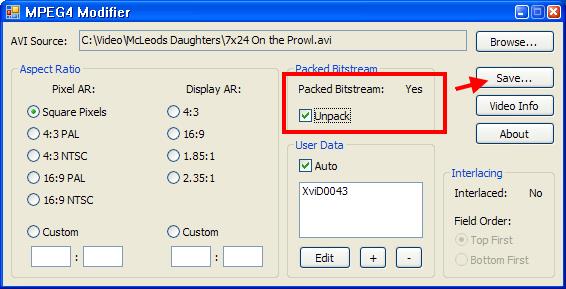

Your problem is almost certainly packed bitstream. Easily fixed with MPEG4Modifier or a firmware update. -

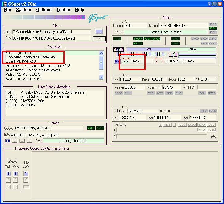

also, i checked the choppy movie with gspot....
under video: 773 kb/s QF=0.207 bits/pixel
in fact, all the movies i've tried with choppiness problems
are way under the 8000 kb/s that the 5982 can handle.
i'm hoping maybe i just got a dud, and a simple exchange will
solve my headaches. -
Did GSpot show packed bitstream? You can fix that in a minute with MPEG4Modifier.

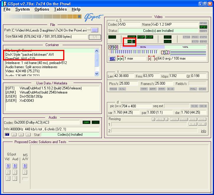

well, i had initially checked with gspot 221, i saw that you used 2.70
so i tested again using 2.70
here's what i found:
the choppy movie that played on the 5982
was "packed bitstream", 23.97 fps, 769 kbps, QF 0.206, 608x256
so like you mentioned that would explain the choppiness.
but another movie i tried that did play smooth on the 5982
was also "packed bitstream", 25 fps, 936 kbps, QF 0.166, 640x352
btw, both movies played smooth on the norcent
so do all 5982 owners have movies that play choppy when the
file is "packed bitstream" ?...or is it just my unit?

GSpot doesn't report this but there are single b-frame and multiple b-frame packed bitstream. Most players don't have a problem with single b-frame, only multilple b-frame. Once again, try using MPEG4Modifier to unpack the bitstream.
So, anybody got a link to the 5982 firmware upgrade that will enable it to play packed bitstream Divx without being choppy? My mom's asking my dad for a DVD player for the den and I told him to get one that plays Divx. He said he didn't see one at Costco (although, I think he probably doesn't know where to look) and I know they've got a 5982 at Sam's Club and we're going there tomorrow to pick it up. My dad's a little impatient and wants to buy one right away and I'm afraid it'll probably be the 5982. I was able to talk him into getting a 5960 before, and I upgraded with Fsweds firmware, and now it works perfectly. I really need to be sure that I'll be able to get the 5982 working fine with packed bitstream files, because I just want to drag and drop to a flash drive without any hassle. Thanks in advance!

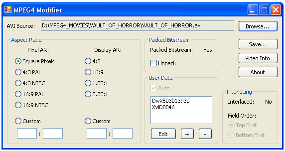

If you have an XviD or DivX file with PACKED BITSTREAMS then just do the following:
Fire up MPEG4Modifier and load the AVI file.
You should see something like this:
See the box that says, "Unpack" ?
Click on it. Now click on the SAVE ... icon and input a new file name.
It will save a copy of the file to a new file and the new file will not have PACKED BITSTREAMS. No loss in quality.
It is very simple and only takes a few moments. Should take less than a minute.
I usually name the new file _unpack so using my example VAULT_OF_HORROR_unpack.avi
Now you are ready to burn to a CD or DVD etc.
- John "FulciLives" Coleman

Oh, I've got MPEG4Modifier, and have been using it to remove the packed issues, but last week I was havign some weird divx playback issues NOT on my standalone, but on my PC! Someone was posting some australian tv shows,and even though I DO have the divx codec on 2 systems here, I couldn;t play them at all.
I figured they also wouldn't play on my standalone, and even though I hadn't unpacked them, I just renamed them to avi to see if the phillips could play them, which it did fine. I do remeber the next day unpacking at least two of them for a final burn for the Phillips, and that's what I tested playback with. All 4 episodes played fine, even though I remember two of them needing to be unpacked for the final disc.Gary Tabar Jr. -
Since you seemed to be unsure whether you had unpacked the files I was suggesting you check if they are currently packed or not and see if they had multiple consecutive b-frames (packed bitframe with single b-frames isn't a problem). MPEG4Modifier can tell you if the have single or multiple b-frames in its Video Info dialog. This will definitively tell us whether the firmware update fixes the multiple consecutive packed b-frame problem.
Yep, I can confirm at least here, I can now play packed divx avi files nice n smoothly, without any stutter at all!
Before I'd get a choppiness or stutter when there were things like a pan from left to right.
