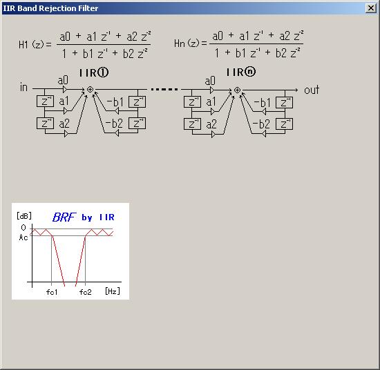

You should able to filter it out with a band reject filter.

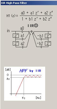

If the hum has a low frequency then you can use a simple high pass filter.

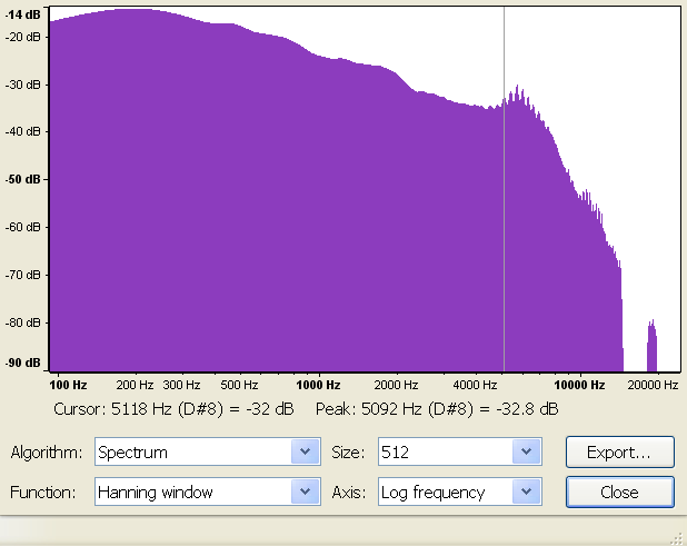

Thanks a lot for the info. I am a newbee in audio matters. I selected 12 seconds of sound where the noise is distinct and analyzed it. Here is the spectrum graph. Could you please tell me which frequency to use in which filter. Your help is greatly appreciated.

Most of the rumbling comes from the 100hz and below range. Here's your audio with the <100hz lows pumped up to hear it.
noise02_95hz.mp3
The hissing is in the 4K-7K range

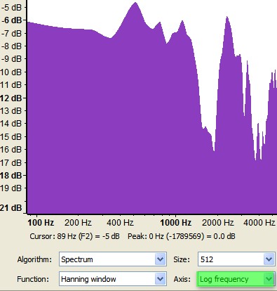

Other than voice, what other audio of interest are you trying to hear? Voice needs parts of the 1000-5000 Hz band. you can filter out below that. Seagulls etc. are higher frequency. Music will be tough to isolate.

Thanks a lot folks. Following your advices I managed to suppress some of the noise. If I go further manipulating the sound the conversation becomes unclear. Your help is greatly appreciated.
