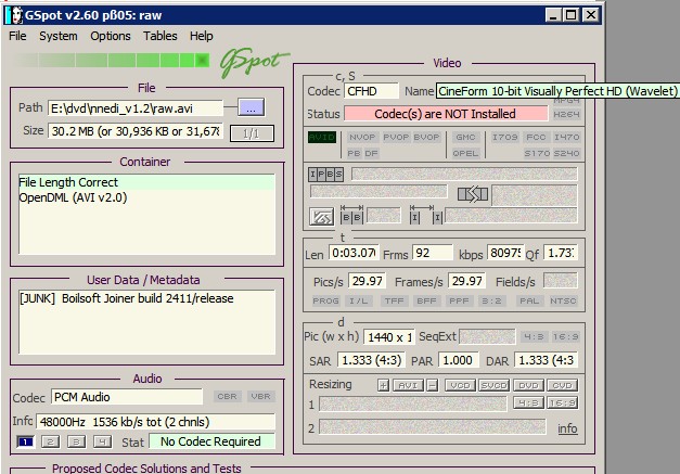

The raw avi file i have is here http://3vuecs.com/raw.avi

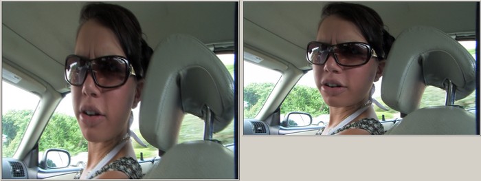

when i load this file into tmpgenc, it loads as aspect ratio 1:1 (square pixel) which makes it look like it is in 4:3 really, so i change it to display 16:9 but it still seems messed up when i go to export. can you look at the sample and see if it is captured wrong and if so what needs to be done differently?

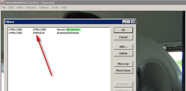

This seems to be right:
Deinterlace, then save it as 1440x810 and import it into your editor. Then render at 1280x720. There are other ways to do it, but that's the simplest I can think of. -
ok, for the rest of the footage i am getting from them, what should i tell them to do differently
There should be a setting with the HDlink capture card software to capture at 1920x1080. 1440x1080 works for M2T because of the pixel aspect ratio of MPEG, but those rules don't work in AVI land.
