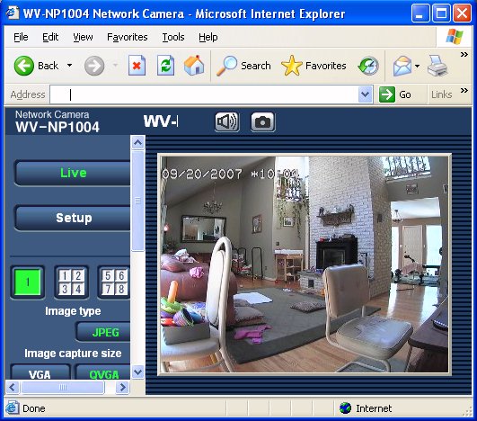

    Well, thanks for reading and for any advice. I've attached a snap-shot from my Panasonic WV-NP1004 security camera's web interface (which I can monitor from work) - on lowest resolution
