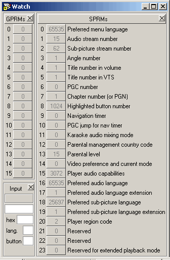

First you need to learn about the hardware DVD player itself:
It holds a number of registers, SPRMs , that is changed as you play a DVD disc.
As you can see "SPRM 18" holds the preferred subtitle language (here "da" = 25697 (which is danish)) etc. etc.
It also holds registers, GPRMs , that your code can use in navigating the DVD.

I can highly recommend PgcEdit for stepping through and watching the navigational code in any DVD.
