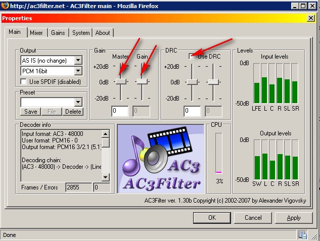

    Some AC3 filters have an independent volume control that can produce low volume by default. Check that before you re-encode the audio.

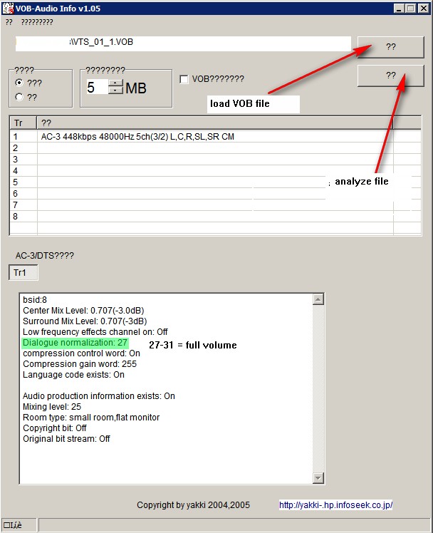

    Yes, it could be your PC playback software, as the guns1inger sayeth. You could install Ac3filter and tweak the output levels: Also, read the author's article on dynamic range compression for PC playback:
    http://ac3filter.net/guides/dynamic_range_compression
    If the issue is with the file itself, you can determine this with an easy to use Japanese utility:
    vobaudio105.zip
    Just two buttons:
    Here's vobdnorm from coises
    vobdnorm-1.0.zip

    Strange, vobaudio said dialog normalization was 31. Burned the DVD which plays normally with good sound.
    The weird thing is that I dont have problems with AC3 sound usually.
