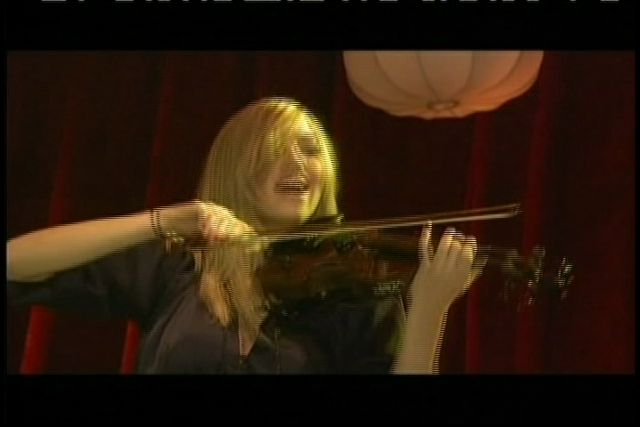

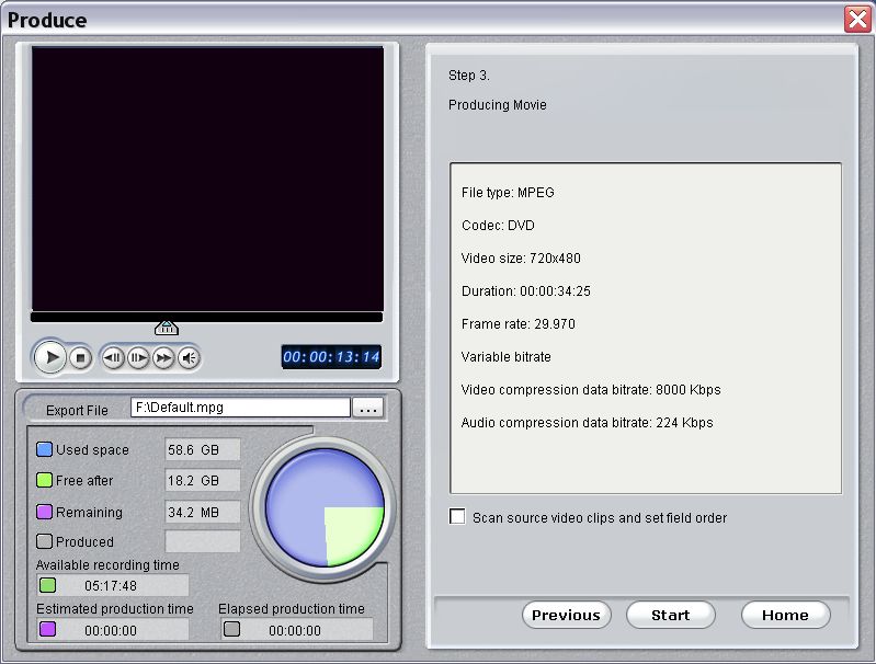

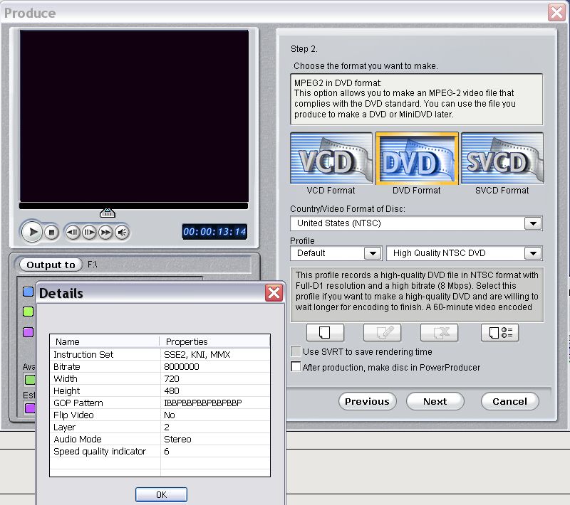

I am using powerdirector to convert dv avi into mpeg2 (720x480, 8000bitrate) but it is always interlaced
especially on fast camera motion , i replaced vga card and got a 256 MB nvidia but still having same problem
how to fix it ??
thanks for any help
Results 1 to 30 of 33

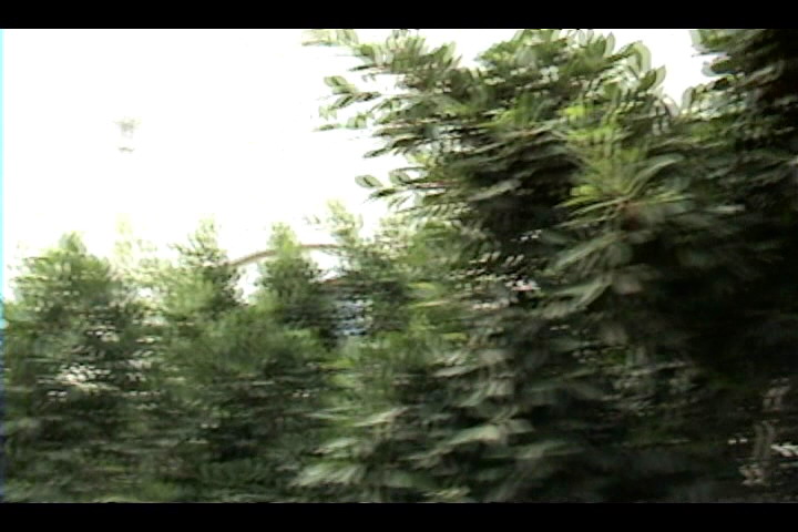

That file has been blend deinterlaced.
DV format is 720x480i/29.97fps interlaced so that is what you want. Set your editor to 480i and encode 480i MPeg2 for TV. The TV will handle deinterlace if necessary. If you don't want interlace for computer playback, use a deinertlacing player like VLC or PowerDVD.Recommends: Kiva.org - Loans that change lives.

Yes it has, but it could be the player he was using to take the pic that did it. It could still be interlaced. And if so, I agree with you that it's the way it should remain. If it was really blend deinterlaced somewhere along the line, that's the last thing he should want, and he should start over and do it right this time.Originally Posted by edDV
no matter how i play it using windows media player or power dvd or on my dvd box it is always like the picture above , is there any mpeg2 codec will prevent deinterlace while encoding ? i thing the codec within my software is causing this
Both of those players may be deinterlacing it. To be sure of how it was really encoded, open the video in VDubMod and scroll around. Or go into your players' configure or preferences and check to see if all deinterlace is turned off.
In my old PowerDVD, I right-click the screen and go Configuration->Video->Advanced->Video Mode->Force Weave. If it's interlaced, you'll see the lines. If it's blend deinterlaced, it'll look all blurry. You can pause it and advance a frame at a time to have a closer look. I can't help with WMP as I refuse to use it.
If you really did deinterlace it, it's nothing to do with a codec, but some setting you applied, intentionally or not, in your encoder. -

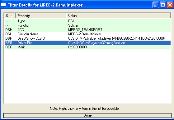

I loaded mpeg2 file in Gspot and found it uses main concept and ulead decoder i deleted both and endocded again but exactly the same result appeared again

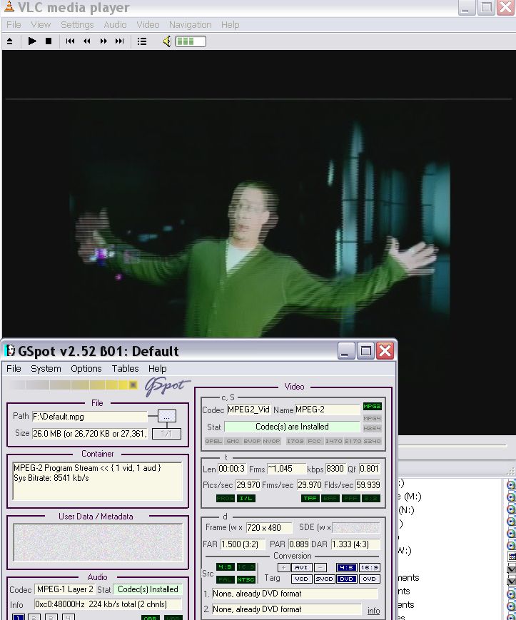

Here is the 4x3 MPeg2 out of the Mainconcept encoder to compare with Power DVD3. They look similar.
Screencap again is VLC Snapshot with deinterlace off.
and the VLC Bob deinterlace during playback

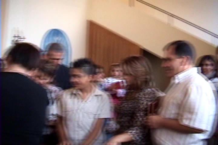

yes same here i am able to deinterlace in the power dvd and get a good play result but the problem when burning to dvd and playing on stand alone dvd box it is still interlaced but even worth as they mentioned it is blend deinterlace which i have no rememdy yet i am not able to figure out a way to encode from dv to mpeg2 without getting a blurry interlaced footage.

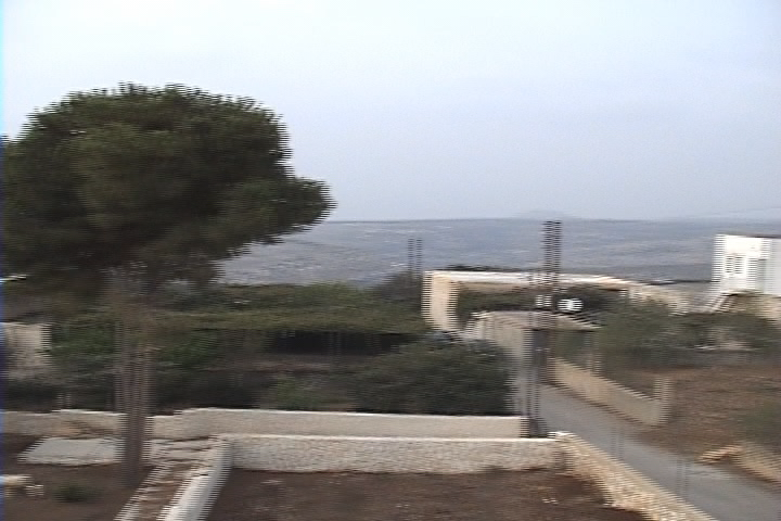

Had you bothered to do that 2 weeks ago, you might have saved yourself a lot of anguish and time. Here's an untouched frame from your encoded VOB:Originally Posted by manono
So, I guess your frames were being deinterlaced by your players. -
As mentioned above, VLC makes a good player and frame capture reference so we can compare. Intelace playback uses the "disable" setting under deinterlace. Your player must be blend deinterlacing.

Yeah, the encoded VOB looked OK to me. I couldn't find any sign that it had been improperly resized or anything else that might prevent it from playing normally on a standalone DVD player.
You had been showing us pics of it deinterlaced. My default MPC also blend deinterlaces. That's why I had suggested opening it in VDubMod, which shows you the unprocessed raw source. As soon as you do that, you see the interlacing. As near as I can tell, it's been encoded properly, and I can see no reason it won't play OK in a standalone DVD player.

did you try to play my vob in vlc ? set it to deinterlace and you will see
like a double edge all over . This is ecxactly how i see it on my standalone,
