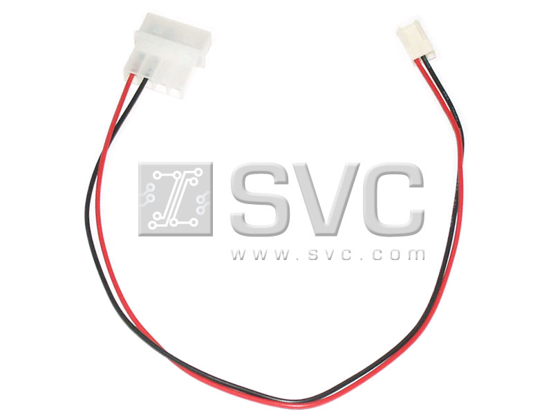

I've recently built a rig using an Antec 900 case that has 4 fans supplied as well as the standard CPU fan.
I'd like to add a fan controller to the system than can not only vary fan speed but can also switch off the case fans when not needed.
However, the four case fans are powered by a 4-pin molex plug whereas all tha fan controllers I've seen use the standard 3-pin connection.
Are there and fan controllers that use only 4-pin imput or are there and 4-to-3 pin connectors that I could use with a 3-pin fan controller?

This probably doesn't help you much, but the three pin connector includes a 'sense' lead for RPM reading where the Molex just uses the 12VDC straight from the power supply. If you don't need speed indicators, or your speed control doesn't need them, there should be adapters out there. But most go the other way, to adapt 3 pin fans to the four pin Molex connectors. Don't know where you might find one in the UK, but this one appears to be what you would be looking for: http://www.svc.com/4to3ad.html It needs to be female on both cable ends.

Well, I ended up going doen the 4 to 3 pin converter route.
Bought 4 from misco.co.uk for £1.29 ea. Even on such a cheap item, there are retailers trying to rip you off - overclockers wanted £2.34 for the exact same item. Where do they get off?
