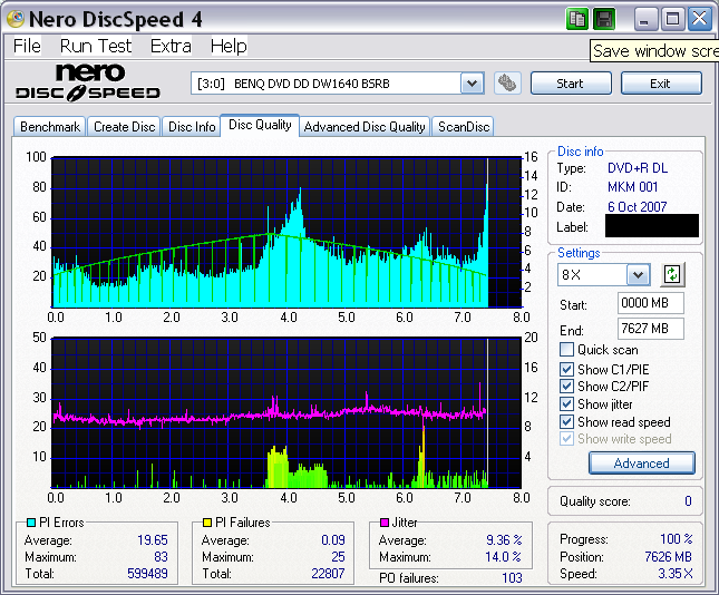

I've been using Verbatim DVD+R DL discs for a while now, and I've just bought my first spindle of their 'Made in India' discs. The results were not pretty. I used my BenQ DW-1640 burner to make the burn (using ImgBurn), and the first disc out of the spindle was a disaster. Though I've been able to burn these 2.4x discs at 8x in the past, this one burned at only 2.4x for the first layer; it burned at 8x only for the second. When I ran Nero Disc Speed and ran a Disc Quality scan, it reported a single PI failure of 1500 right from the get go! I threw that coaster away and tried again. The next disc was pretty bad:Originally Posted by bacardi/avt
I've never gotten PO Failures before, nor have I ever gotten a Quality Score of '0'. I'm going to play the DVD and see if there are any problems with it, but I've never had scans this bad before with Verbatim. My Playo discs look better. -
