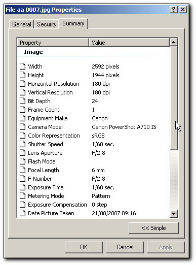

Thanks - I'll look into it. Is there some obvious way to tell if there is exif data in a jpeg?Originally Posted by ChrissyBoy

Well if you can - just hover your mouse over an image and you will get a popup with camera model/date taken etc... this is the exif data.Originally Posted by deanbrown3d
Or do a right click-> on an image:
Yes, of course I have turned that off. Will do the other recommendations tonight.Originally Posted by AlanHK
-Dean -

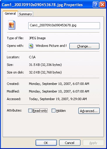

I get this dialog when I right-click and select Properties:Originally Posted by ChrissyBoy
Choose the Summary tab.

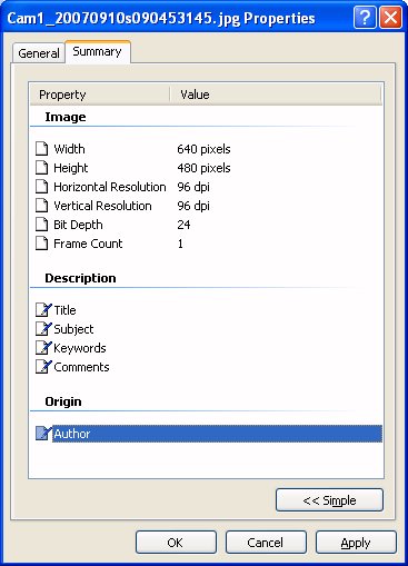

Dammit I'm sure I looked at that! It was on the advance button of the summary tab. I assume this picture means I don't have exif data:Originally Posted by ChrissyBoy
