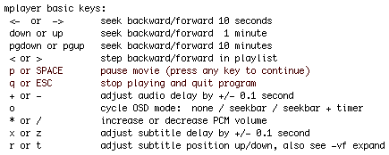

I have an Intel Mac and having problems with MPlayer when working with ffmpegX as well. That's why I came here. I'm trying to convert a VIDEO_TS file into an .avi file and need the subs to be included. So, since I'm new to all this, I'm trying out the different options and I need MPlayer to give me a preview of what I'm doing. MPlayer starts up ok, plays ok, but there doesn't seem to be an option to stop the preview. Once MPlayer starts, ffmpegX is inaccessable and within MPlayer there's no 'pause' button or some other way to stop it from playing. So I click the red button in the upper left corner. Then MPlayer quits altogether and I get a window telling me that MPlayer crashed and what do I want to do? I tell it to leave it at that and when I'm lucky it will, when I'm not lucky it keeps starting up and up and up and so I have to force it to stop (cmnd+option+esc). Also, when MPlayer crashes, I get an arm's length report from ffmpegX telling me that MPlayer crashed 'by bad usage of CPU/FPU/RAM' and that I should 'Recompile MPlayer with --enable-debug and make a 'gdb' backtrace and disassembly'. I have no idea what all this means. ffmpegX also tells me all sorts of things about this or that invalid whatever, or that the seleccted video-out device is incompatible with this codec, which is rubbish since I wouldn't be getting errors like this if MPlayer wouldn't crash. So, like you I'm curious as to what's going on here. And since I have never worked with ffmpegX and MPlayer on any other Mac, I would at least like to know how one can (or ought to be able to) pause MPlayer in ffmpegX.
