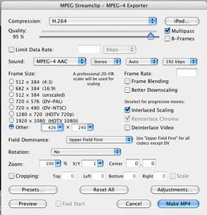

Open up MpegStreamclip, and then open the .VOB file
( should be .01.vob) on the disc.
When prompted, open all files in the stream,
then under Edit, select Fix Timecode Breaks.
with that done, then export to Mpeg-4.
In the export window, select the settings I have listed below
export then upload that file to Youtube."Everyone has to learn, so that they can one day teach."

To check the output, open the output MP4 file in QuickTime Player and do a Cmd-I. A new window should give some information about the file. It would be interesting to see what this info is for your large file, and help pinpoint the anomaly.
terryj posted a nice screenshot with export settings.
Maybe you missed a bit when copying those settings?
For best quality, you should export again, VOB to MP4,
but you could shrink the large file, MP4 to MP4,
either way with terryj's settings. -
it is possible by doing one of two things:
1. You can adjust the quality down to bring the file size down.
Adjust the slider from 95% quality to say about 60% quality
( but no lower than 50%), and this will dial down the file
size considerably.
2. A tip I picked up from Joseph Nilo and I also saw
on DJTV,
is to adjust the audio settings down,
choose MPeg-4 AAC, and change the AUTO setting down to
44.1khz, and the audio bit rate to 160kbps.
this will also help shrink the file size down."Everyone has to learn, so that they can one day teach."

I did a test output with a 0:01:52 DVD source that ended up being 52.1 MB with the quality slider at 95% (3888 kbps total, according to QuickTime). Whoa. Nothing fancy compression-wise: no water, no fire, no high action, just three people talking.
Then I used a bitrate calculator that said 303 kbps (for video) should be enough. MPEG Streamclip helpfully gave a nice estimate of 6.6 MB. Using that to number to limit the data rate, it came out at 6.5 MB (484 kbps total, according to QuickTime). There was a little bit of quality loss (less texture) compared to previous try, but very acceptable at a much more download-friendly size.
Can't say that I figured out the quality slider yet, but 95% with H.264 may be a bit much for 'just' a site.
