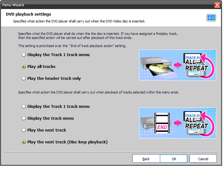

In the Menu Wizard, there will be a page that looks like this:
It's changed a bit since TDA2, and I haven't needed to build a new menu since I've upgraded, but I would say try selecting "Display the Track Menu" in the bottom section.
[EDIT]
What Roma-Turok suggested would probably be best; it used to be easier to select that in the Menu Wizard. -

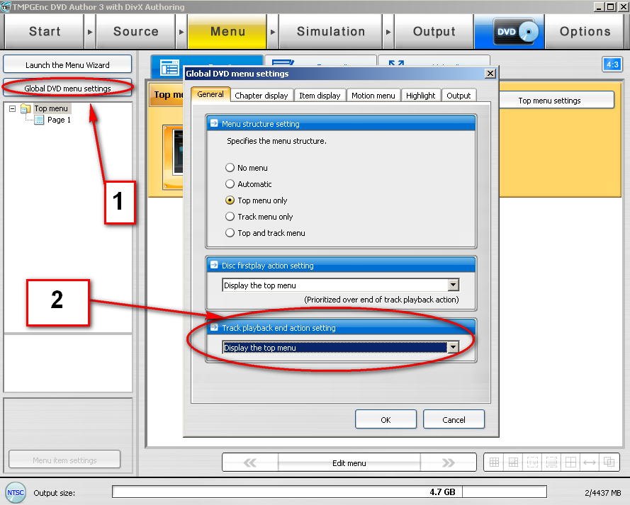

OK here goes......
Firstly, it looks like all your videos are on the same track.... SO......
Make sure each video is on it's own track by using the "add a track" button on the source page.
Follow Roma_turok's advice to set the Global menu settings as shown.
Apart from "glamming-up" the actual menu screen - that's all there is to it - honestly....Don't worry.......we'll be alright... -

Hi JonnyCabs
Thanks for the fast reply, its nice to have someone to ask questions to with more experience.
I've got it sorted now. Your reply was correct, the videos were all on 1 track and I have now put them onto separate tracks and all is okay so far.
I've put some music on the menu too and just burnt a test disk too and it worked ok.
