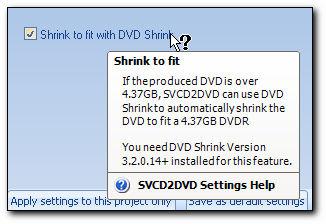

It is only activated for source which will be encoded (mkv, avi, ts etc). If you are using mpegs which don't require further encoding then they won't be as this would be unnecessary and would incurr a loos in quality.
The recommended path therefore woul be to create the DVD as normail and then use DVD Shrink to reduce the size slightly.SVCD2DVD v2.5, AVI/MPEG/HDTV/AviSynth/h264->DVD, PAL->NTSC conversion.
In fact with the latest build: If you have DVD shrink installed and you have the following selected in your settings:
SVCD2DVD will automatically use DVD Shrink to "shrink" DVDs that are too big that it produces...SVCD2DVD v2.5, AVI/MPEG/HDTV/AviSynth/h264->DVD, PAL->NTSC conversion.
