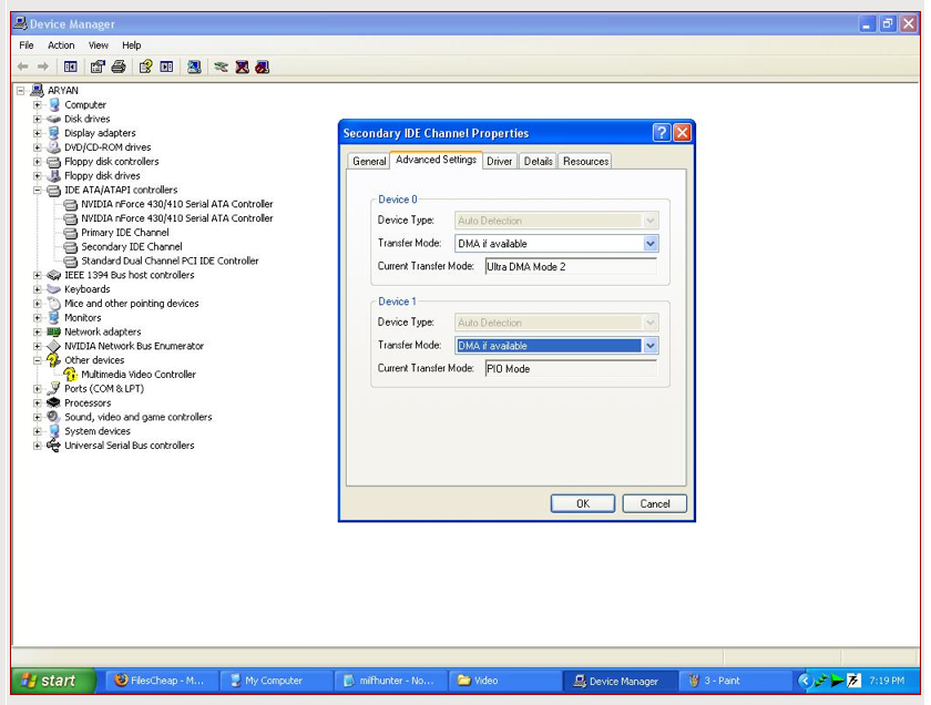

    These R my settings:-
    I never Touched These Settings,As i am not aware of the terms.so you can tell me what is wrong in them?

    The screen cap shows PIO mode is "current transfer mode"
    That is most likely your problem. You may have to remove both ide channels and let Windows reinstall them, then restart your computer and go back and make sure the settings stick.

    I did The Needfull,I uninstall the Drives,Remove the Cable and Re-insert them,And Reinstalled them,after that This is the Current Status:-
    But No Help!
    The First Pic Is of My DVD Writer,It is As Usual Negative....Ya can see the Changes In My Combo Drive In 2nd Pic.
    But Nothing Happened,,It is one and the Same thing!
    This Is My Worst Position,My Most Reliable DVD Writer is no More Working,and COmbo After showing DMaA Avaialibility,Still Not Reading..(Combo Read Once,After that No Way)

    The pictures show ide channels in dma mode, which is good. Highlight the dvd/cd rom drive and click the + to show what's connected. It looks like everything is fine. If you put dvds in the drive and then things crash, I would assume the drive has gone bad.
    If one drive is bad and both drives are connected to the same ide channel, Windows will dumb down the ide channel, not the drive, so you will lose the proper use of both drives.
