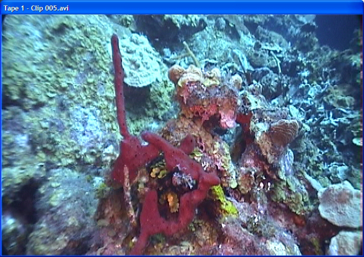

  15. If you want to see what a proc amp can you, you can use our software (see signature). It has a built-in real-time proc amp that you can use live while capturing. Some of the functions are implemented in such a way as to introduce no loss in quality of the original.
    To give you an example of what a proc amp can do, here's an example. The subject is a group of underwater coral and sponge. It is common for underwater video to have a bluish cast:
    Good correction of this can be achieved by adjusting the chroma part of the video signal - specifically offsetting the Cr and Cb components. In effect, this changes the white balance in a manner that is difficult to achieve in an NLE (I haven't come across one yet that lets you add/subtract from the individual components). Anyway, the proc amp has a split screen function to help:

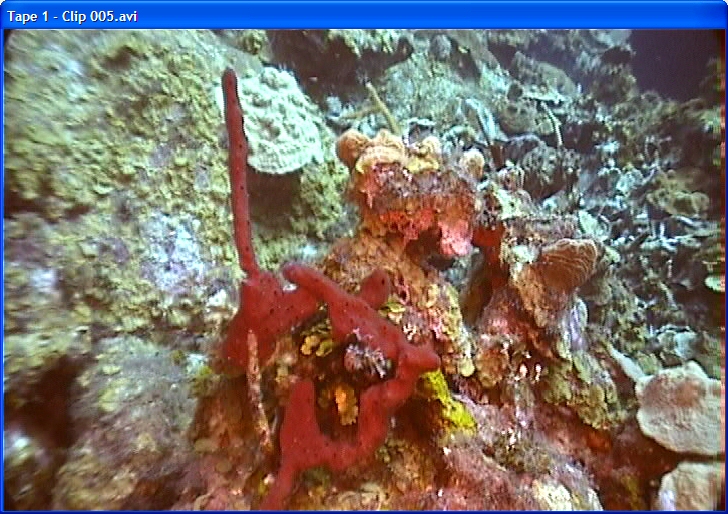

    And the final result:
    A hardware proc amp or our software can do this in real time. For the example of underwater video, the correction required is constant, so you just set it and capture. This saves a lot of time and, as I mentioned earlier, corrections like the one given here have no impact on the quality of the image. If you are interested, I can provide the gory details.....
