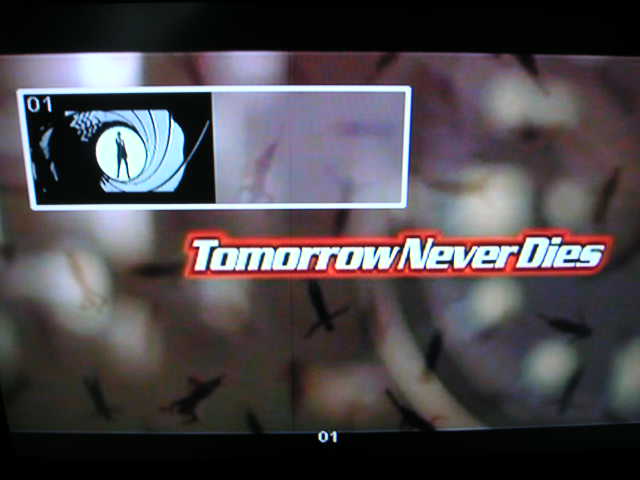

  2. The Toshiba XS series offers the ability to produce custom title and chapter menus. It is my understanding the Toshiba XS series were the only DVD recorders sold in North America to offer this. It is very powerful. The pics below are examples. Not very good ones but there were handy.
    Here's an example of a custom title menu. Notice the custom backround and custom thimbnail:

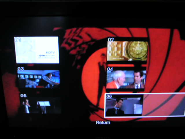

    And here is an example of a custom chapter menu. Again notice the custom backround and custom chapter thumbnails.
    You can do a lot more than what these pics show. Again I believe only the Toshiba XS series offered this capability. The process is very similiar to what you see with PC editing programs.
