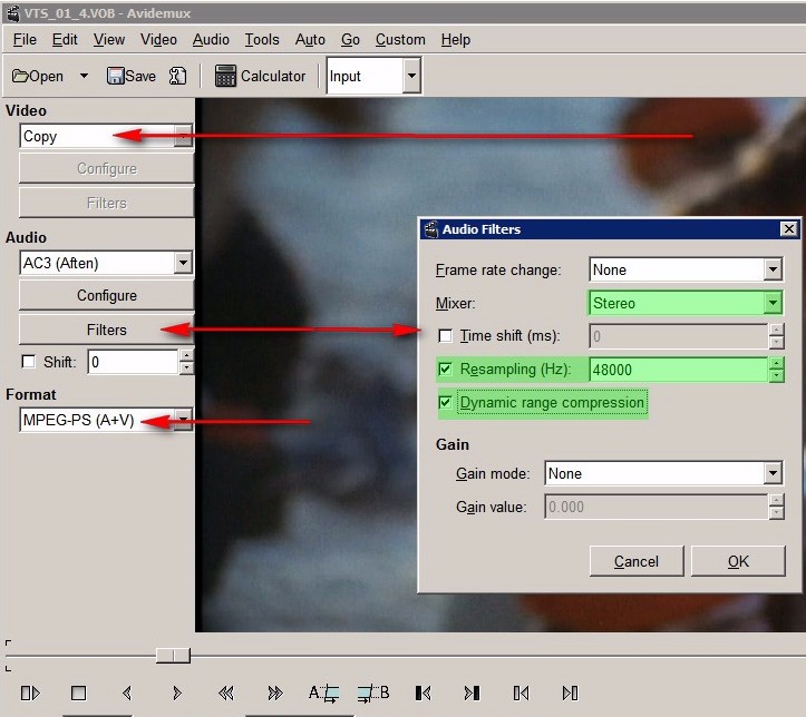

  6. Member Soopafresh's Avatar
    Jan 2004
    Avidemux can prolly do it.
    You might have to play around with the A/V sync. The easiest way to get an idea as to the skew is from the info on the audio track itself, after you've loaded the VOB in Avidemux. I chose the opposite to the amount of delay on the audio track.
