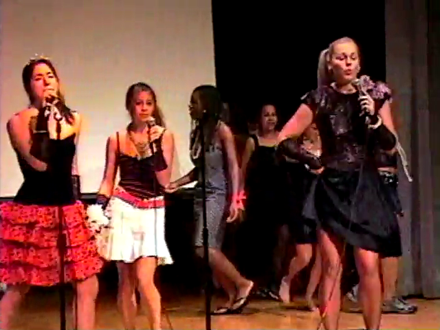

    The other is to do a proper crop and resize before encoding. Here are before (top) and after (bottom):
  7. Originally Posted by Knightmessenger View Post
    The camera used was a Sony video 8mm TRV-32 which had really good color (often almost as good as a 3ccd) but did not have a manual exposure option. So yeah, it was slightly overexposed
    Not just slightly. It's horrible. I use AviSynth and not Vegas. The brightness and contrast need to be corrected. Also, the deinterlacers in these NLEs are usually pretty bad. Here's a pic showing the whites (green) and blacks (red) outside of 16-235. All shadow detail is lost as what should be dark grey is solid black. Afterwards is a pic showing some improvement, but it can't be entirely fixed at this point. Does Vega have a histogram with which you can check the white and black levels? It's very obvious when you put one on. Heck, I don't even think the colors are any good as skin tones look kind of 'rosey' to me.

    I did some testing a while back, and that's where that list of optimizations above came from. Unfortunately those tests aren't on YT anymore, but trust me there was a drastic difference in quality. I only saved a representative screenshot, they were from the exact same 4:3 DV-AVI video but processed in 2 different ways. 1 was processed only in vegas ( like you did) , and the other used the optimizations listed earlier. The vegas upload was even 2x the filesize , but half as long in duration (ie. the 720p bitrate was way lower), but the vegas upload still looked like crap compared to the optimized version uploaded to youtube . Look at the details difference in the vest. Now youtube killed it too - all the grain is gone and everything looks "plasticky" and oversharpened but at least it's not a blurry, blocky mess like vegas' export.
    The moral of the story is quality begins at the source - shooting conditions, lighting, decent equipment, stabilization. This is the most important. But at least some improvement can be done in post, and these small optimizations add up and can improve the final quality on Youtube. This example below demonstrates gains between optimizing vs. not optimizing, because the source video was the exact same.
    Processed with Vegas only
    Using Optimizations
