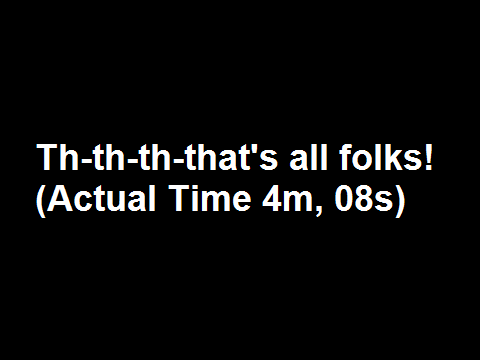

    Okay, for you dark_guard, and everyone else, I'll release my current works so far. It's a mess I'll say, but I'm not calling it final. Use at your own risk. Source code and binary.
    (EDITED: The .NET 2.0 Framework is required to run this)
    http://flvbuilder.googlecode.com/files/flvreader-080630.zip [obsolete]
    http://flvbuilder.googlecode.com/files/flvreader-080704.zip [obsolete, check http://code.google.com/p/flvbuilder/downloads/list instead]
    "FLV Reader.exe" -i yourvideo.flv <-- this will produce video_only.flv to upload to YouTube
    "FLV Reader.exe" -i yourvideo.flv -info > flvinfo.txt <-- same AND output extra flv tag info (megabyte text file)
    It's going to be very verbose. If you have ffmpeg.exe in the same directory, it will make use of it to create a final frame for your video if it needs to do padding. Otherwise, I haven't tested it if it doesn't find ffmpeg. If the video is under 350kbps I haven't tested it. If after auto-padding the file, the duration is longer than 11 minutes, then it probably won't get through YouTube uploads. I haven't tested it. The final frame doesn't show sometimes. All in all, this is really just an alpha product. A tool customized to *MY* needs at the moment.

    Once you've made a FLV video file you'd like to upload, here's what you can try in Windows.
    1) Rename your FLV file to video.flv and copy it to the same directory as "FLV Reader.exe" and "thumbnail.flv.tag" and "rejector.flv.tag"
    2) If you'd like the final frame to show the actual time, you'll have to copy "ffmpeg.exe" into the same directory too so the program can create an image.flv file and extract the video flv tag and import it into our new flv file.
    3) Double click "FLV Reader.exe" to run it.
    4) The output file will be "video_only.flv" which is a holdover name from my tests. It actually has audio too.
    5) Upload this "video_only.flv" to YouTube. Let me know if it works
    If you're familiar with DOS console, I'd recommend you load the prompt instead and issue this command: "FLV Reader.exe" -i file.flv
