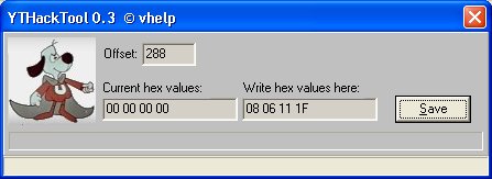

    frifox, I had one last question before I retire to bed -- look it the time.
    you mentioned the offset address. That was one problem I had trouble with. Calculating
    the offset from within the stream that I open, as your basic byte array. Anyway. I post
    a crude snap shot of the tool that I'm working on and you see where I filled in the offset.
    Obviously its wrong, but I just wanted a dummy number in there. Its designed around the
    idea of the drag n drop approach.
    The next of this project was to add other user-friendly fields, such as: width; height; fps;
    padding; etc etc, and various other finds that would be trial n error inside these discussions.
    Well, see you all around..
    -vhelp 4719

    nice one, your tool looks good... so far
    i took a different path, i simply implemented the hack into my batch scripts... works pretty good too

    hexalter uTubeVideo.flv 0x120=0x08,0x06,0x11,0x1F
    *** of course replace "uTubeVideo.flv" with the your FLV's file name
    what the command above does is, it goes to offset 0x120 (228th hex-pair), and replaces the next 4 hex pairs with "08 06 11 1F".
    why offset 0x120? because i've noticed that in all of my FLV's produced with FFMPEG, the first video packet's resolution is located at the same exact place - starting at 228th hex-pair.
    PS: i use values "08 06 11 1F" (16x12) because currently it worked 100% of times for me

  27. Originally Posted by frifox
    This is correct, it's also in the official FLV1 file description. They have to put the first video packet in a static location, because it's a streaming format and the player needs to know this location in order to be able to start at the right place.

    Hi everyone, first. post.
    I have been following this thread with great interest - I make videos of myself performing music to upload, so I need OK quality video and excellent sound! I am having difficulty getting Youtube to not re-encode my vids after 50-10mins, and it's really starting to make me want to bang my head off something hard.
    I am using FFMPEG settings: ffmpeg -i YTvid.wmv -s qvga -b 100 -vcodec flv -ab 128k -ar 44100 YTvid.flv
    And then using: hexalter ChopNew.flv 0x120=0x08,0x06,0x11,0x1 to set the new res.
    Then I am using a hex editor to edit the length of the video to 11mins (it is actually 9:30).
    Is there another stage to the process that I am missing out on Frifox? A pointer in the right direction would be hugely appreciated as I have read every message in this thread about 10 times!
    Thanks!
  29. Originally Posted by si_edgey
    There are a couple of things I see wrong here:
    - The -b 100 command, with that you set the video-bitrate to 100 kbit/s, which is quite low.
    - The time duration extension is a way to fool the average bitrate;
    a video that uses 350 kbits/second for 11 minutes, is technically the same as
    a video that uses 700 kbits/second for 5.5 minutes.
    So if you encode content for only 5 minutes, and YouTube has a limit for 350 kbits/sec bandwidth use in 11 minutes, you can make use of that by spreading the data over fake time, and thus use all data available for those 11 minutes up in 5 minutes
    First, make sure you understand that concept.
    After that you encode your video with the bitrate that fits within the newly created (upped) barrier. It used to be 350, and will then be around 700 kbits/s. That is video plus audio.
  30. Member
    Oct 2007
    no, i encode with FFMPEG and then hex with HexAlter... thats it
    but hold on a sec, you said you used:
    but it should have been:
    hexalter ChopNew.flv 0x120=0x08,0x06,0x11,0x1F
    typo?
