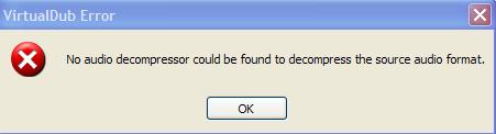

  1. I seem to be having audio decompress problems with a movie i want to make audio louder in VirtualDubMod can anyone help

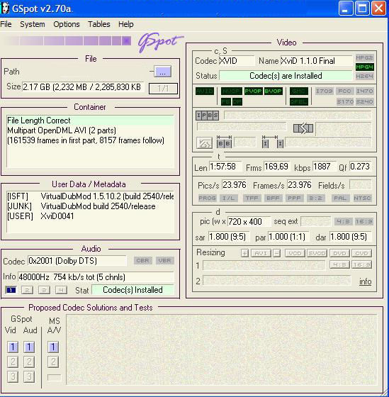

    It's not your fault because Gspot returned bogus audio information, but you actually have DTS audio. "Dolby" and "DTS" are NOT the same thing. You need something that understands DTS. Installing a software DVD player should work. There may be some freeware DTS decoders, but you'll have to look. http://www.doom9.net in the Downloads section (then go to the "full software page" link at the top of the page) and look for the DTS / AVI Filters link. They MIGHT help.

    Virtualdub doesn't support DTS. Even playback of avi's with DTS audio seem to use an AC3 plugin workaround.

    I did the above but virtualDubMod still says the error i started this forum with
