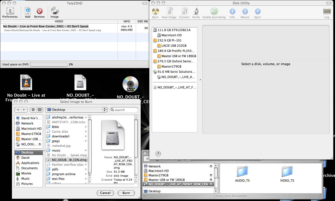

    If you give Tele2DVD the original downloaded clip, just have it make an image from the file. Rename the clip beforehand as an .mpg if you need to. Under Prefs choose NTSC or PAL, where you want the image saved and the target media.
    The resulting dmg is a UDF dvd data image that can be burned from the OS X Disk Utility as an image file.
    It will have the correct structure to be played on a tabletop dvd.
    The file on the right is the original, the middle is Tele2DVD's dmg, the right disc is the dmg mounted, below show Disk Utility, bottom right is the content of the mounted disk.

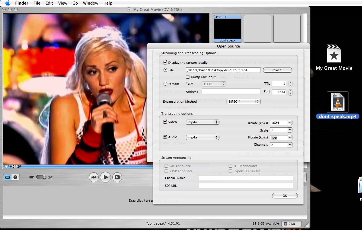

    Okay my goal is to change the video from .mpg to an .m4v or an iMovie friendly file. I wanna try to crop it and to export it into iDVD so I can burn it to a DVD-RW disk.
    May 2004
    You mean like this? I converted the file to an mp4 using VLC first, note the sample settings. I then offered the file to iMovie and it happily imported it.
