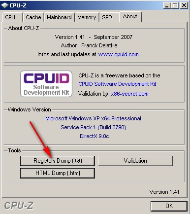

  30. Member Soopafresh's Avatar
    Jan 2004
    Download CPU-Z http://www.cpuid.com/cpuz.php
    Clock on Registers Dump TXT
    Zip the TXT file and post it up here.
