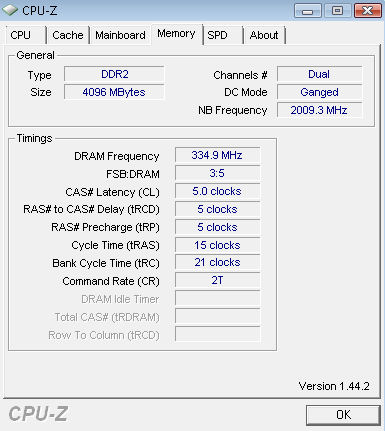

  6. @dhnj - thanks for the results... what are you mem timings and overall mem clock rate?
    http://encoding.n3.net <-- for all your DVD and CD backup needs!
    canada

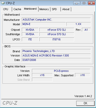

    Just installed a phenom 9850 into an asus m2n-e,have to wait for the am2+ motherboards to get to my town.

  8. @john - judging by your results, you downloaded the 'classic' 480p version of the benchmark. The HD version uses a 720p clip. You can find it at this url. Please give it a try as we only have a few Agena-based systems!

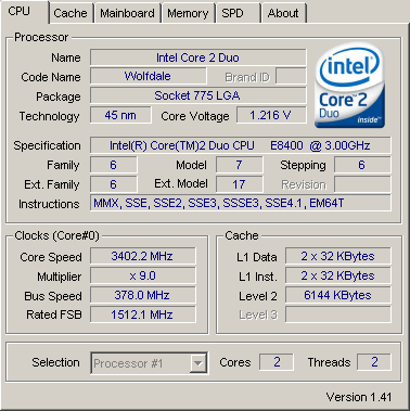

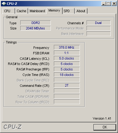

  14. DVD Ninja budz's Avatar
    Jan 2003
    In the shadows.....
    Overclocked E8400 Wolfdale 3.40ghz
    ---------- RUN1PASS1.LOG
    encoded 1749 frames, 100.48 fps, 1850.89 kb/s
    ---------- RUN2PASS1.LOG
    ---------- RUN3PASS1.LOG
    ---------- RUN4PASS1.LOG
    encoded 1749 frames, 100.66 fps, 1850.89 kb/s
    ---------- RUN5PASS1.LOG
    ---------- RUN1PASS2.LOG
    encoded 1749 frames, 25.60 fps, 1826.37 kb/s
    ---------- RUN2PASS2.LOG
    encoded 1749 frames, 25.58 fps, 1826.26 kb/s
    ---------- RUN3PASS2.LOG
    encoded 1749 frames, 25.61 fps, 1826.38 kb/s
    ---------- RUN4PASS2.LOG
    encoded 1749 frames, 25.64 fps, 1826.38 kb/s
    ---------- RUN5PASS2.LOG
    encoded 1749 frames, 25.57 fps, 1826.21 kb/s

    System Details
    Name AMD Phenom 9850
    Codename Agena
    Specification AMD Phenom(tm) 9850 Quad-Core Processor
    Core Stepping DR-B3
    Technology 65 nm
    Core Speed 2511.4 MHz (12.5 x 200.9 MHz)
    Northbridge ATI RD790 rev. 00
    Southbridge ATI SB600 rev. 00
    CAS# 5.0
    RAS# to CAS# 5
    RAS# Precharge 5
    Cycle Time (tRAS) 15
    Command Rate 2T
    Memory Frequency 334.9 MHz (3:5)
    Memory Type DDR2
    Memory Size 4094 MBytes
    Channels Dual (Unganged)
    Windows Version Microsoft Windows Vista (6.0) Home Premium Edition Service Pack 1 (Build 6001)
