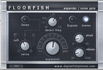

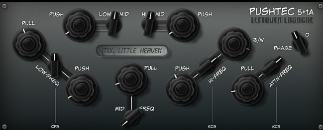

used 2 Free VST plugins with these settings:
thanks soopa I'll give those a shot! I was checking my PM box and noticed you helped me last year at the same time with another wedding audio mishap (i'm so embarrassed!)
