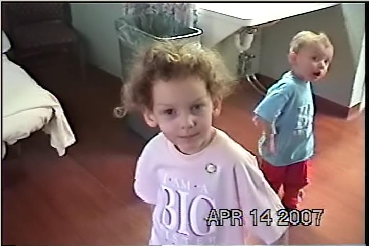

MVtools. Yes, it'll take forever, but your footage will look so much better. If you're using Mpeg2source, make sure to add the "Cpu=4" parameter, as in the script posted below. That will add deblocking.
Before
After

Ok, the good news: The results look great.
The bad news: It took 1.5 hours for a 20 second clip!
It will take 22.5 days to do 2 hours.

I thought it was over filtered. Notice how all the detail in the floor and kids' hair is gone.Originally Posted by chrishallowell

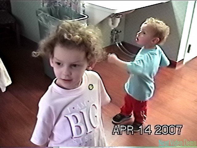

The sample video was free of compression and denoising artifacts so it's a good place to start.
You need to figure out why you can't capture at 29.97 fps though.
Here's what the Neat Video noise filter for VirtualDub can do for it (before, after):
I left some of the noise (a little noise is your friend -- it prevents posterization artifacts) and notice you can still see the pattern in the wallpaper and the grain in the floor. I only have the demo version of Neat Video so I had to crop the frame down to 640x480. -
