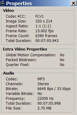

15.002 FPS - it does not look good.
Waht's info from other apps (especially from FLV Extract)?
And what's other files FPS?

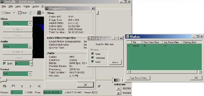

Look at this:
[quote="Placio74"]15.002 FPS - it does not look good.
This appears to be another issue...
Some wrong with reading total video duration... and then 'wrong' calculating FPS...
6390 frames / 425,943 sec = 15,002 FPS
BTW
If You demux video to AVI used FLV Extract and open in Avidemux, I guess then show more accurately total video duration (~426 sec) and then calculate 15,000 FPS.
Unfortunately, I not see easy way and without issues to join FLV's.
