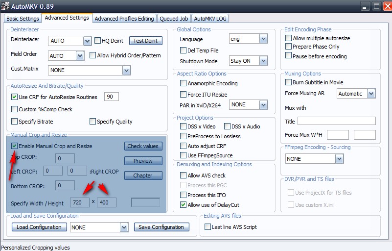

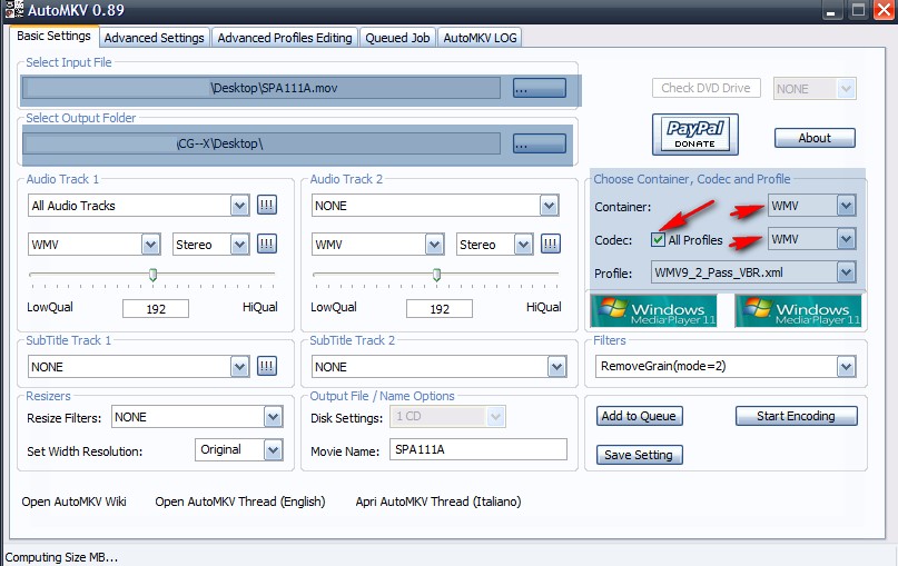

 In case you run out of options with the above solutions, try this:
 1) Download and install Avisynth 2.58
 2) Download AutoMKV
 3) Load your Quicktime and choose the following settings
 4) Go to the "Advanced Settings" tab and choose your output dimensions:
 5) Then finally, tab back to the main screen and click "Encode"

	PAL in this case only pertains if you're encoding to a DVD. But since he wants a WMV file (Windows Media), you have to keep the aspect ratio square, especially since his source is 1024x576. To downres to 720 width, the correct height would be 400.
 Besides, you mentioned in your first post he was okay with NTSC as well. Neither PAL nor NTSC standards pertain in your setup.

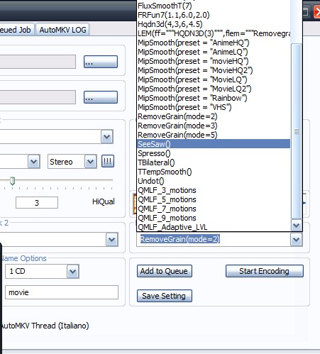

	Will the quality be the same.... hmm... that's probably the reason this site exists.
 You'll prolly have to futz with it a few times to make the quality as good as possible. That's just how it goes. You can test out a few of the filters to sharpen the image. I'd suggest SeeSaw

	So why choose WMV9_2_Pass_VBR.xml for the profile? I'm just trying to understand this more. What's the difference from WMV9_1_Pass_CBR.xml for example?
	2 pass provides smaller file sizes and better quality in areas which are more detailed.
 Pass 1 analyzes and determines bit rate to allocate to scenes
 Pass 2 encodes, using the information provided from Pass 1
 Doing a 1 Pass CBR means the same bitrate allocated to the entire video - faster, but usually a much larger file size than the 2 pass method
