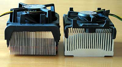

Which leads to an OFT - Wouldn't it be nice if some CPU cooling company built an adapter which could replace the crappy and loud fans on a stock Intel cooler with a 90 or 120mm ultra quiet fan? I know why they don't - they want to sell that hunk of metal and the silver compound. Sure would be a simple thing to make, though...

They are fairly common. Often 60mm to 80mm, but you might find a few 60mm to 120mm adapters out there. Just do a search for ' cpu fan adapters '.Wouldn't it be nice if some CPU cooling company built an adapter which could replace the crappy and loud fans on a stock Intel cooler with a 90 or 120mm ultra quiet fan?

with you about the dinky stock Intel coolers. They are so crappy and cheap.

I've used those before, redwudz, but I don't think they'd fit an Intel supplied heatsink. - I was envisioning something more like this, but with clips which could fasten to the specific heatsink of any model Intel (actually Foxcon) boxed CPU.
http://images10.newegg.com/NeweggImage/productimage/35-186-122-01.jpg
Replace all of the black plastic on these examples:
The heatsink's aluminum/copper construction isn't that bad - they're pretty heavy. -

I'm not that familiar with Intel CPU coolers. I do like the heat pipe coolers like budz linked to. That gives you a small footprint at board level and lets you put a bigger fan further up into the airstream.
