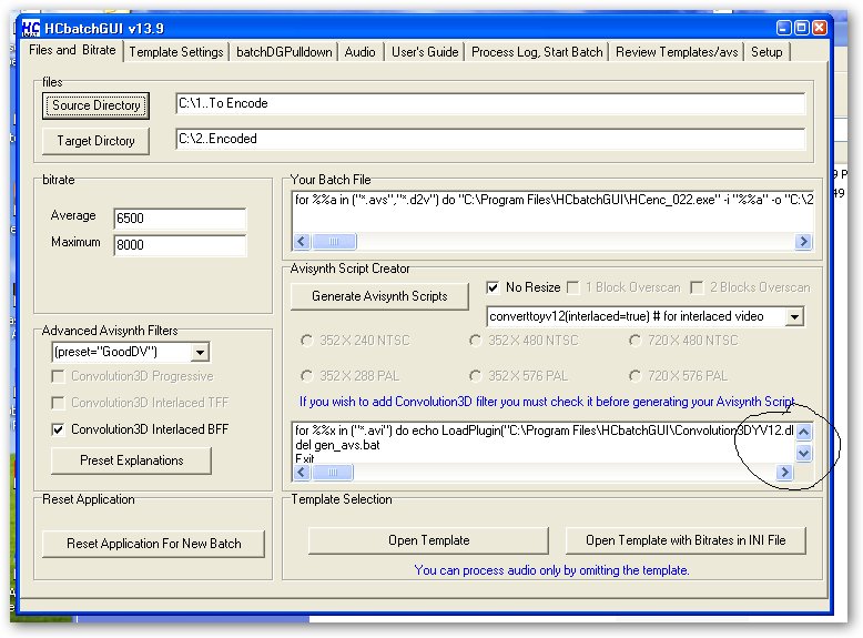

2. I am attaching a pic....look where I circled....for looks sake do you think you can add some added space between the up anb down arrows of the avisynth box? Would this apply to the "Your batch file" box as well?

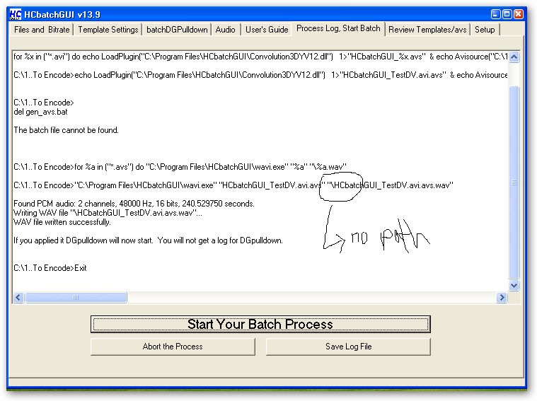

4. There is one bug....the audio file (whether you do audio only or audio with encode) is not saved in the target directory. It is now save on my system root drive....that is C: The video is put where it is chosen to go, but the audio is sent to c:\. For example, I put my stuff to encode into a "To Encode" folder....once it is encoded it is to be saved into a "Encoded" folder. Audio is never sent there.

The only way to add more space between the arrows is to make the boxes bigger. Unless I enlarge the gui size I really don't want to do that.2. I am attaching a pic....look where I circled....for looks sake do you think you can add some added space between the up anb down arrows of the avisynth box? Would this apply to the "Your batch file" box as well?

For 2, it is just cosmetic....I am all for having stuff look good so if it were me I would expand the boxes a little, but it is not really that important, so I defer to you.

Now for 4, my "bug" report, it will work ok if you manually choose the output folder, however it is bizarre. The video ALWAYS is put in the right spot no matter what (I checked a few times). For some reason if you let the program remember the settings the audio is forgotten about if you do not manually specify the output folder.
See attached a screen shot of the audio saving....as I circled and wrote in, the path does not seem to be sent!!! But this only seems to affect audio....it is a nice feature remembering stuff....but if it introduces issues feel free to leave it out.

I left out one silly little line for the audio. Sorry...
It should be fixed now. It should remember your audio path now. You will have to press the target button and select the directory button to initially set up the path but from then on it will remember it for you.
